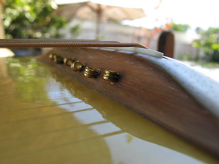

I took a very carefull look at the pic of your bridge.
I can't see a pulley effect where the strings exit
the rear of the bridge. Im sure there is a slight one.
But the picture showing the front section with the ball
ends has very little tension, The low e string almost looks loose where it enters the front of the bridge.
Your second pic (blown up)makes it looks like some of
the ball ends are not pulling tight on there mount.
The reverse bend in the strings exiting the rear of the
bridge is where the bulk of the tension is.
I hope you can find these views as a helpfull observation, I have no intent to critcize your efforts.
I just hope this helps!
Tom

[QUOTE=Tom Morici] Rich
it is always refreshing to see experiments. If we all
built everything identical nothing could ever be improved. Someone has to walk the other path.
So I pat you on the back for that.
Tom[/QUOTE]
Tom,
      Thank you for the kind words. I think the pictures may be deceptive. I am absolutely sure the ball ends are seated, and that the strings are all tight from the bridge to the stop piece. I have had the guitar tuned up for several days and it is holding it's tune very well. If there was a binding issue it would have been painfully obvious due to tuning issues. I had a great deal of concern about that very problem while I was shaping the bridge. I had even thought about laying a brass pin or inserting a piece of graphite. After shaping the radius at the wrap. I thought it had a good chance of working(so I gave it a go, with fine results). I think it would be a good idea to address this area if I used a different wood(say mad RW vs the Blackwood I used here).
From the comments so far... I have noted the concern about the tail piece footprint being a potential week link, Possible issue with the bridge glue joint(footprint being reasonable), concern about binding at the wrap around area, concern that the wrap around area is a movable pulley with a mech. advantage of 2(doubling the shear on the bridge glue joint).
I guess the biggest variable to me when designing was the effect of the wrap. It seems that is kinda what I am hearing from some of the respoces also. Mechanical advantage is diminished with friction, and extream friction would lead to binding. From my observations friction is absolutely present, but not so much that it has caused binding issues. I wish I could quantify the shear as that would probably tell me a bit about the level of friction also. Maybe a test model could shed some light(I just have to figure out how to put one together.
Peace,Rich

PostPosted: Thu Nov 30, 2006 1:58 pm
Posts: 170
Rich
Thanks for clarifing my mistake about seeing the ball
ends of the strings not being tight to the mount.
I must ask how your design is that much different
to the last one we all commented on. Please look at this
picture that clearly shows the A and D string ball ends
not snug against the front of the bridge.
Your design is similar,even though you have less binding
of the string as it exits the rear of the bridge.
It would still have to reduce the pull on the ball end.
I also see 3 other points that I feel reduce the pull
on the string ends. Comments please.
Great Post,
Tom
http://www.moriciguitar.com

PostPosted: Thu Nov 30, 2006 2:59 pm
Posts: 503
Location: Portland, Oregon
Tom,
   I suspect that picture could also be a little deceptive. However I recall looking at the bridge you are showing, and the strings took a hard turn into a metal sleeve. I could imagine it would have the potential to bind a string(especially a wound string). The strings wrap around a much larger and smoother radius on my bridge(more akin to a wrap around TOM). Like I mentioned before. As long as the strings can overcome the friction at the point they wrap(not bind)friction will be equal throughout the length of a string.
      The biggest difference between the bridge in your picture and mine. Is that I am attempting to counter some of the twisting force that lifts the rear and pushes down on the front of a normal bridge. I am attempting to do this by having the strings break at an upward angle from the bridge to the stop piece(lifting the front of the bridge). At the same time I am countering the twisting force I am also trying to clamp the saddle harder between the the two oposing forces. The hope would be that a better coupling or grip on the strings would improve energy transfer to the soundboard.
    There are a few other things I am doing with this guitar. Hoping to see improved performance. My neck is raised and has positve angle. I have a few little mods in the box also, but I didn't really want to muddy the water much more with those elements.
    If it fails tomorrow I will be happy. It has been fun, and it sounds and plays great. I will definately try to use what I am learning on the next build. I really appreciate all you guys sharing your knowledge.
Peace,Rich
PostPosted: Thu Nov 30, 2006 4:03 pm
Posts: 170
Rich
Thank you for your response. I did consider that your design had the rounded exit point vs the sharp one in the pic I posted. I am glad you allowed us to express
what we felt we where seeing.
